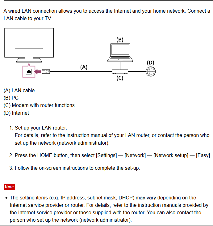

My query is about the "...not guaranteed for this TV".
It is as if they say "... not guaranteed for anything working on this TV"
And then what is the TV that is "guaranteed" for 10/100mbps ?
Just haven't seen this before.....:smileyconfused:

It sounds like a standard disclaimer.
There not saying it will not work just they cannot guarantee a particular speed or connection

Ok you are right
But this is what should be:
and not "no guarantees". A "healthy" network should be the their only mentioning....
