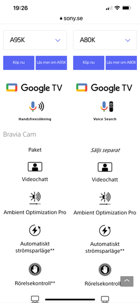

hi, read below
response from sony support
This TV does not come with a built-in microphone, so it is not possible to activate the voice control with the command "hey google", but you can only use the voice control by clicking the voice button on the remote control. (Microphone in remote control only)

Yes this TV has a built in microphone. It also has the switch and software options for control of the microphone. I am in USA. Maybe where you are it is different ? Thanks
