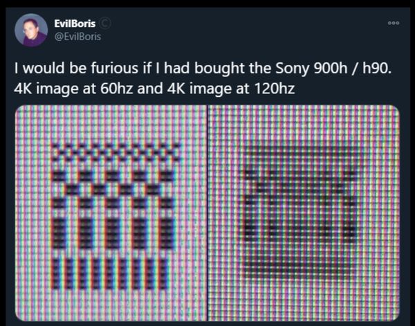

  • The xh90 (uk) has been advertised as being able to display 4k @ 120hz for
    fast clear motion. Unfortunately so far although the motion is smooth ,
    clear it is not. I have read many sources from renowned experts regarding
    the so called 4k @ 120hz burr. I have myslef played destiny 2 and some of
    the horizontal lines character bars etc flicker and shimmer and have what
    is know as the rope effect. In tests it seems like the sony xh90 can not do
    native 4k @ 120hz, the results conclude as of now it can not
    do per pixel resolution on the vertical lines. Is this a hardware issue ?
    Or software and is this TV able to fully do 4k at 120hz ?

Below are 2 examples showing clearly that when tested with a more than
capable gpu top picture, then one below i can share a link
https://youtu.be/gOxVqq088Cw
Sony has tried to address this issue but it as of now still is unable to do
full 4k when 120hz mode is enabled? Is this TV able to achieve full 4k
120hz with out blur? Or not? At 60 hz any resolution seems not to be
effected? I would honestly like to know if tye mediatek chip in the xh90
has enough power to process full 4k 120hz or not?

 also these images too!, this is proof as of now that the sony xh90 can not do full 4k@120hz with out loss of detail . All I would like to know is this TV capable of doing full native 4k with no loss in pixel both on vertical or horizontal lines @120hz ?
