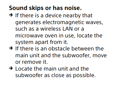

Hello @TheParader,
I found the following troubleshooting steps you could try:
The reference is to page 34 in the manual.
I would put my hopes on changing the RF Channel and only try the other tips if that doesn't improve the connection.

Hi,
Make sure there are no electro-magnitic devices located between soundbar and subwoofer, if issue still the same you can contact Sony reps, they will direct you to the service center for inspection.

Hi all
Thanks for the replies....my Virgin Router sits on the floor below the Soundbar....could that be it?

Try to turn it off and check if it is still doing the same

Hello @TheParader,
that could be the issue and interfer with the wireless connection between the soundbar and the subwoofer.
Have you tried changing the channel though first?
