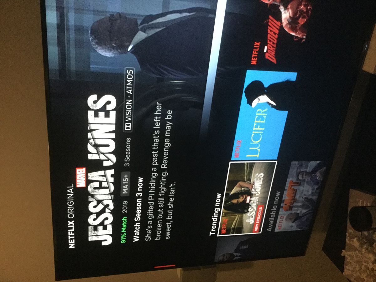

I have a 2019 75” X95G and I can’t get Netflix to spit out Atmos. Netflix says it’s available as per image but it only sends Dolby digital + when viewing on my amp. I have capable equipment etc. I think it must be firmware but question is when will it be available

Hi, I have the HT-ZF9 Soundbar connected to my KD55-AF9 via eArc.
When watching Dolby Atmos content via SkyQ - pressing the display button on the soundbar remote shows “Dolby Atmos” on the on-screen message - So all is good there and working correctly.
But - The TV’s built in Netflix app shows programs available in Atmos, like your picture, but when watching, I press the display button on the soundbar remote - the soundbar led display just shows “Dolby Audio DD 48khz” - not “Dolby Atmos” so I am not sure whether it’s the Netflix app, the tv or the soundbar that’s stopping the Atmos soundtrack being delivered or if it is actually Atmos but it’s just displayed as “Dolby Audio DD 48khz” rather than “Dolby Atmos”
