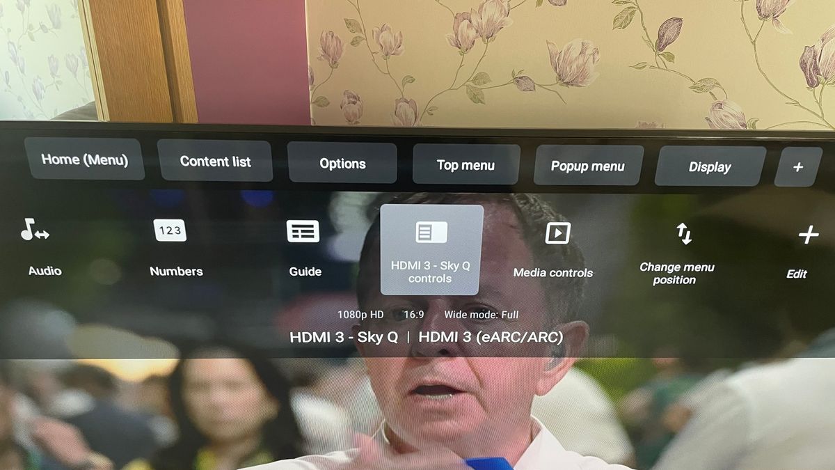

Is it possible to use the Sony remote control to control some options on a Sky Q box?
I have a Sony Bravia KD-50X80LU Remote Control and would like to control some features of a Sky Q.
If I press MENU on the Sony remote control, I get options called "Sky Q controls"
With options like Home, Options, Display etc...
Yet when I choose any of those menu options, nothing happens.
Have other people got any advice what to check here?
Has anyone managed to get these menu options to control their Sky Q box?
