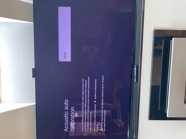

Hi there, thanks for the reply.
Yes I believe I'm using the in built Acoustic auto calibration accessed via Settings > Picture & Sound > Acoustic auto calibration.  I don;t have a soundbar or AV system, just trying to use it with the TV's speakers.
Not an app I've downloaded.
Have attached a series of photos of what I'm doing and the final result.

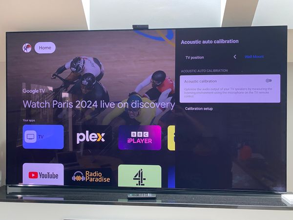

First thing I notice in the third image the acoustic calibration button is set to off.
Click on it and it should move to the right and turn blue, indicating it is on.
does that make any difference.
Is  it possible for you take the images of your screen directly in front of the TV rather than to the side and preferably
in landscape format.

Unfortunately when I toggle acoustic calibration to on the same thing happens - it takes me to the same "Force Stop" etc screen as if I was trying to run the calibration app.  Landscape photos attached.
